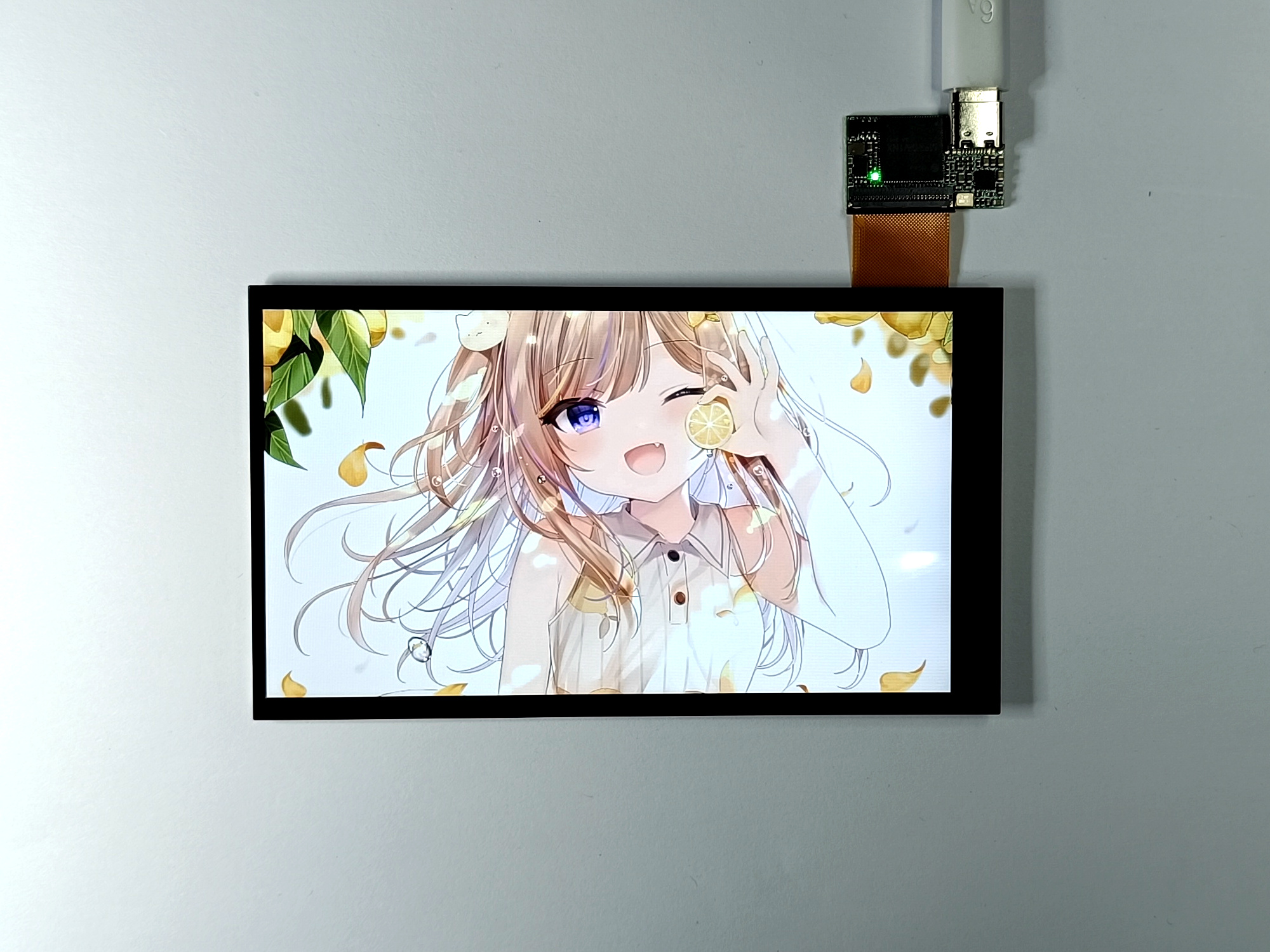

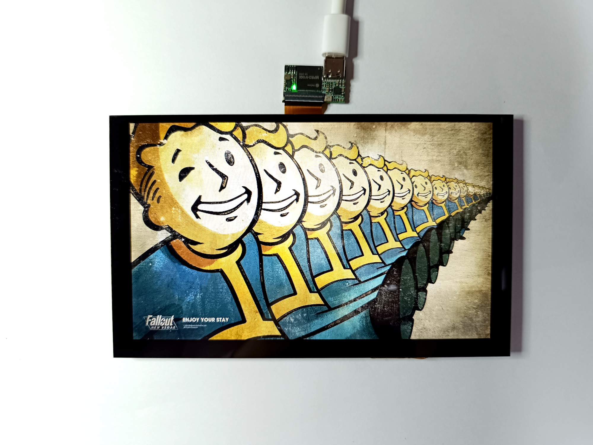

VoCore Screen is a fast screen for high quality display usage for embed devices. It uses USB2.0 port to display real color(24bit) at 25fps, fit for video, embed rich UI interface application. It is designed for the device who does not have MIPI, HDMI or other video interface but only have USB2.0 interface.

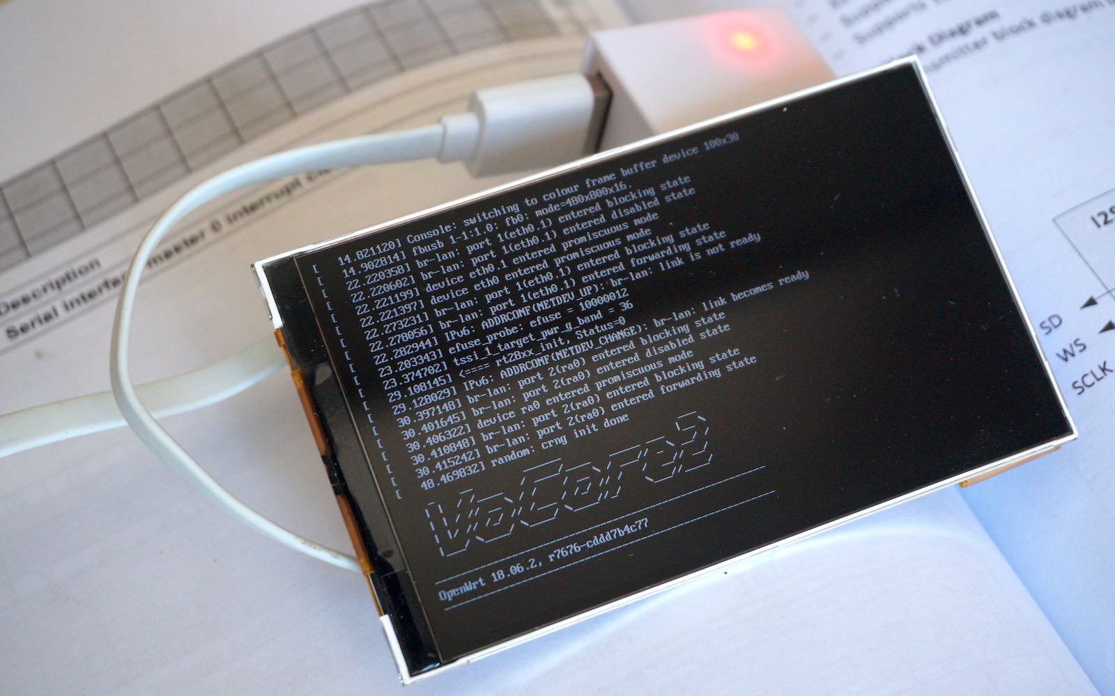

DEMO VIDEO: Play Doom on VoCore2

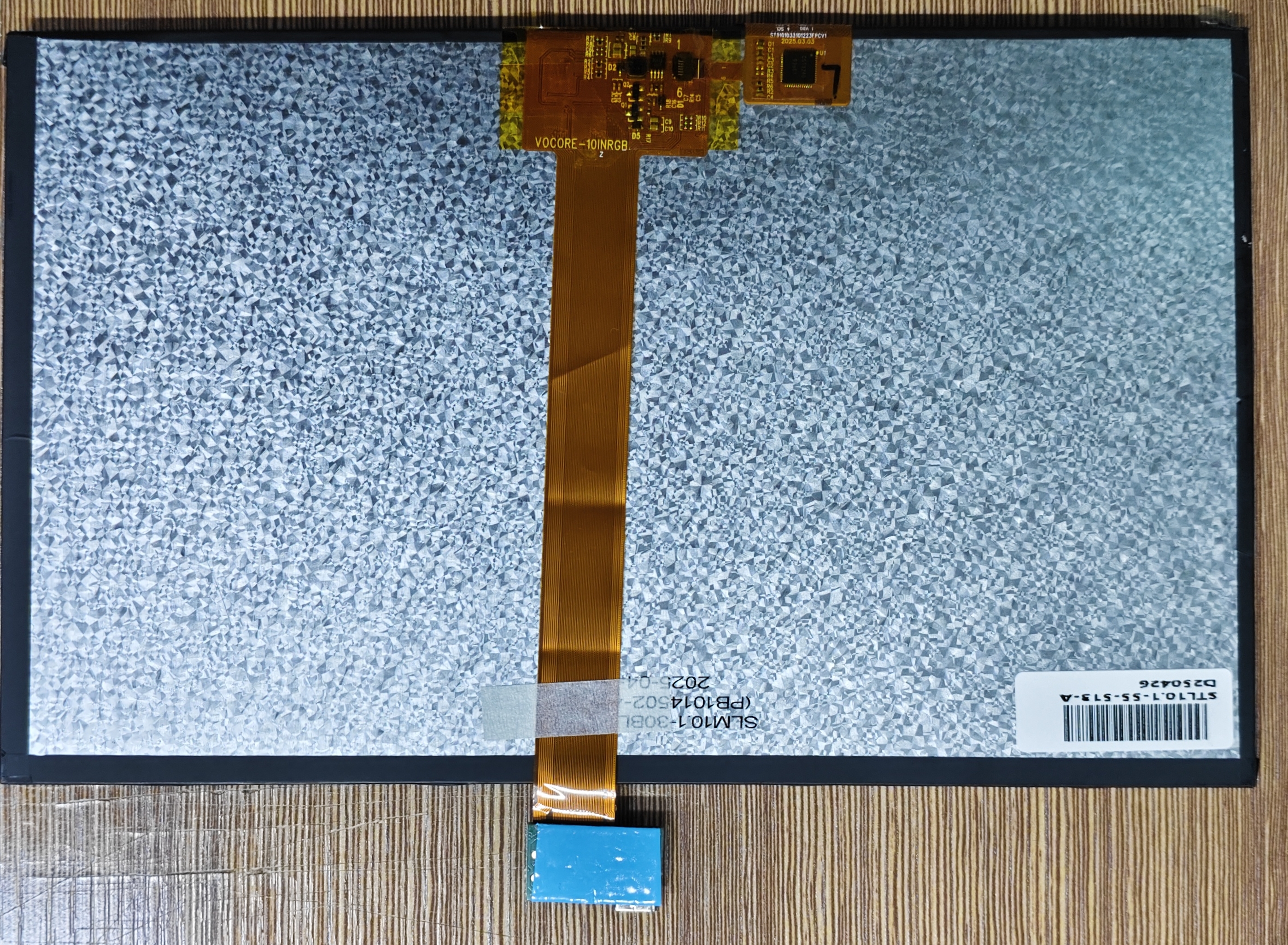

Note: 10-inch Driver Board Thermal Double-Sided Tape
The thermally conductive double-sided tape attached to the back of the driver board can fix the board in place or be used to mount heat sinks for better heat dissipation.
It can also be directly adhered to the metal housing behind the screen to assist with heat dissipation.

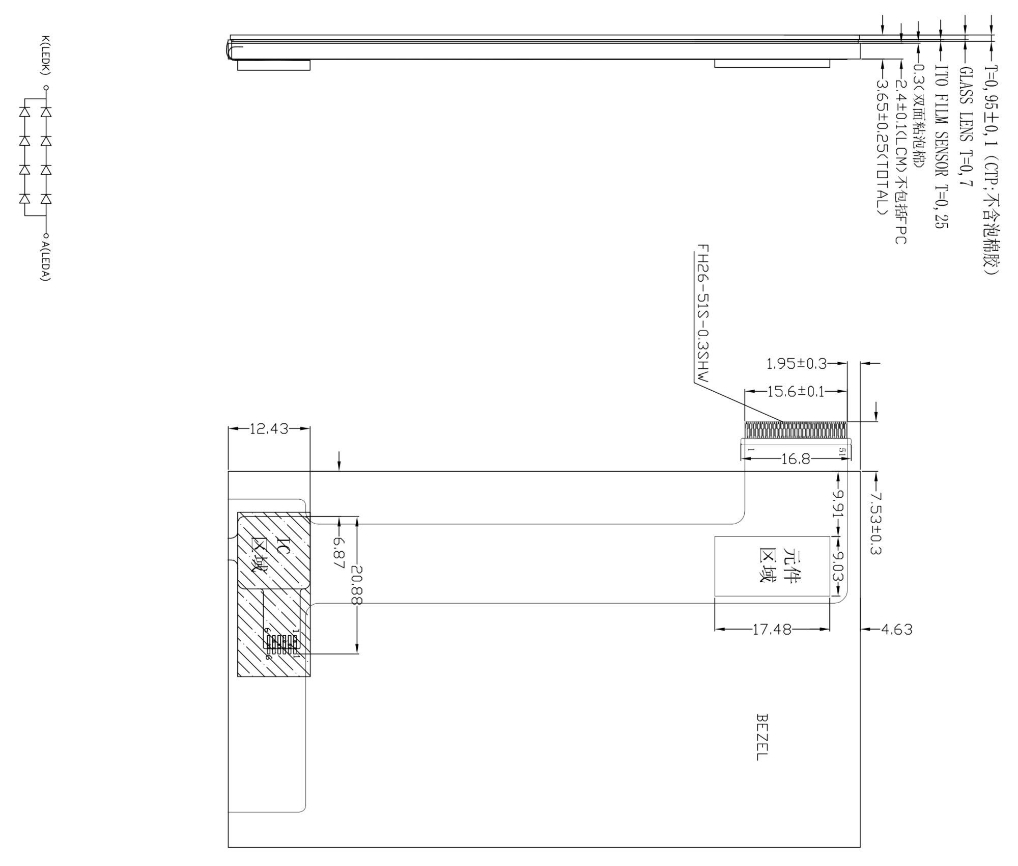

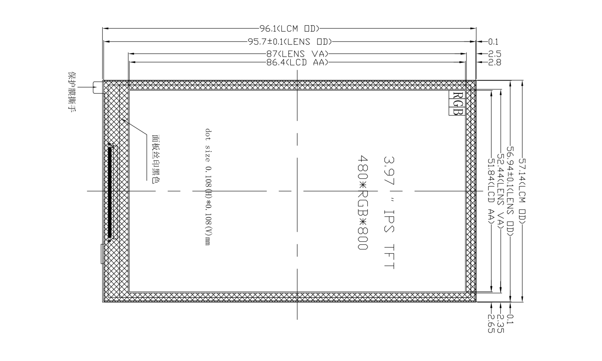

4inch Screen Dimension
3D Model(.step): Link

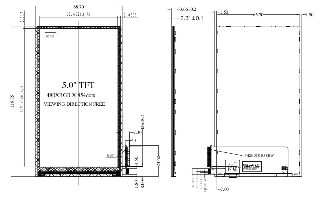

5inch Screen Dimension

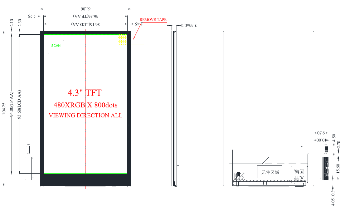

4.3inch Screen Dimension
3D Model(.step):Link

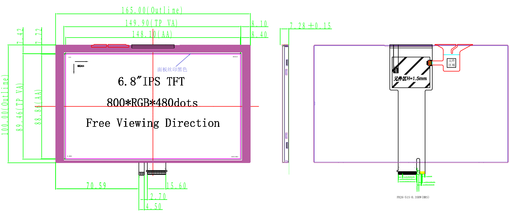

6.8inch Screen Dimension

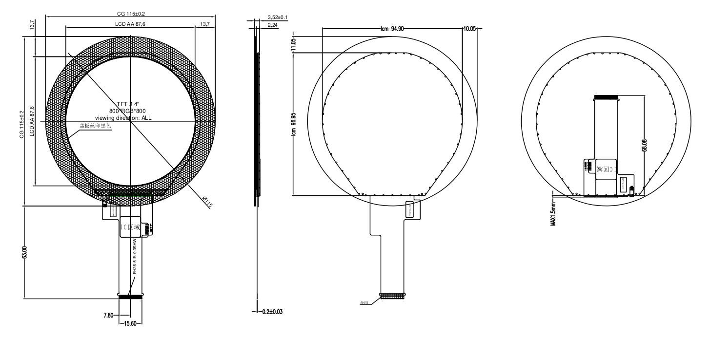

3.4inch Round Screen Dimension(default shipping version)

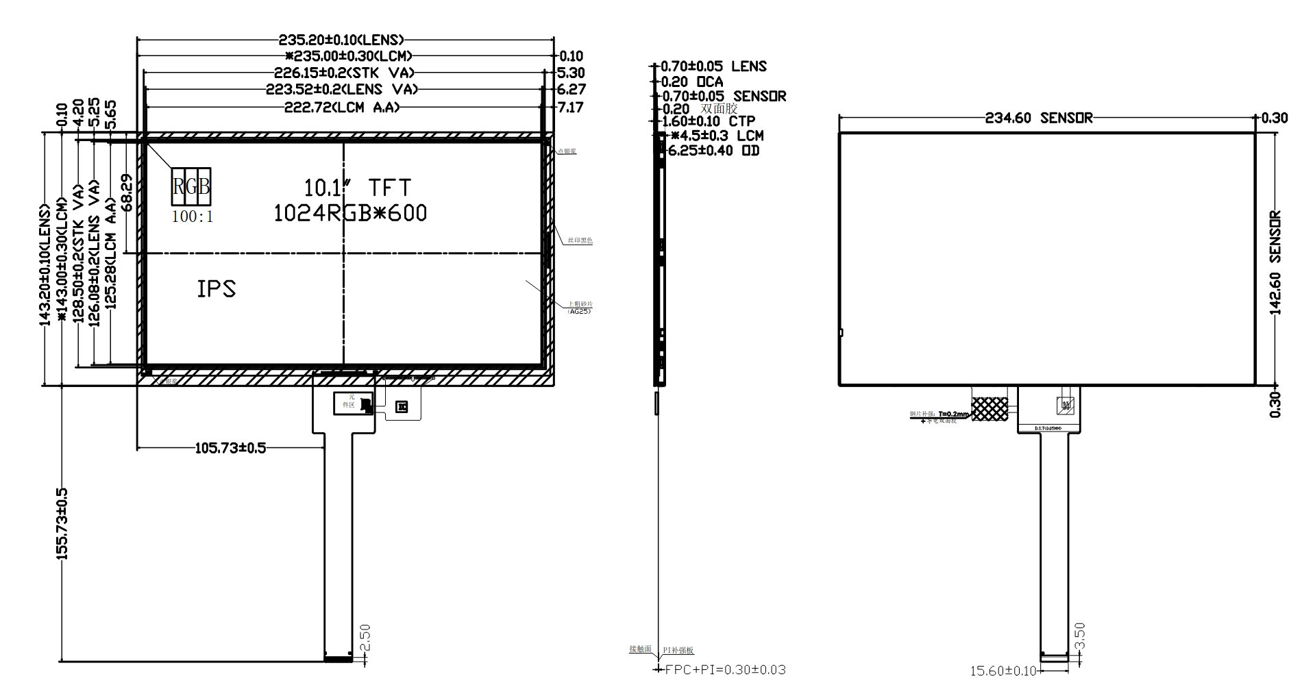

10inch Screen Dimension(recommend heaksink on driver board)

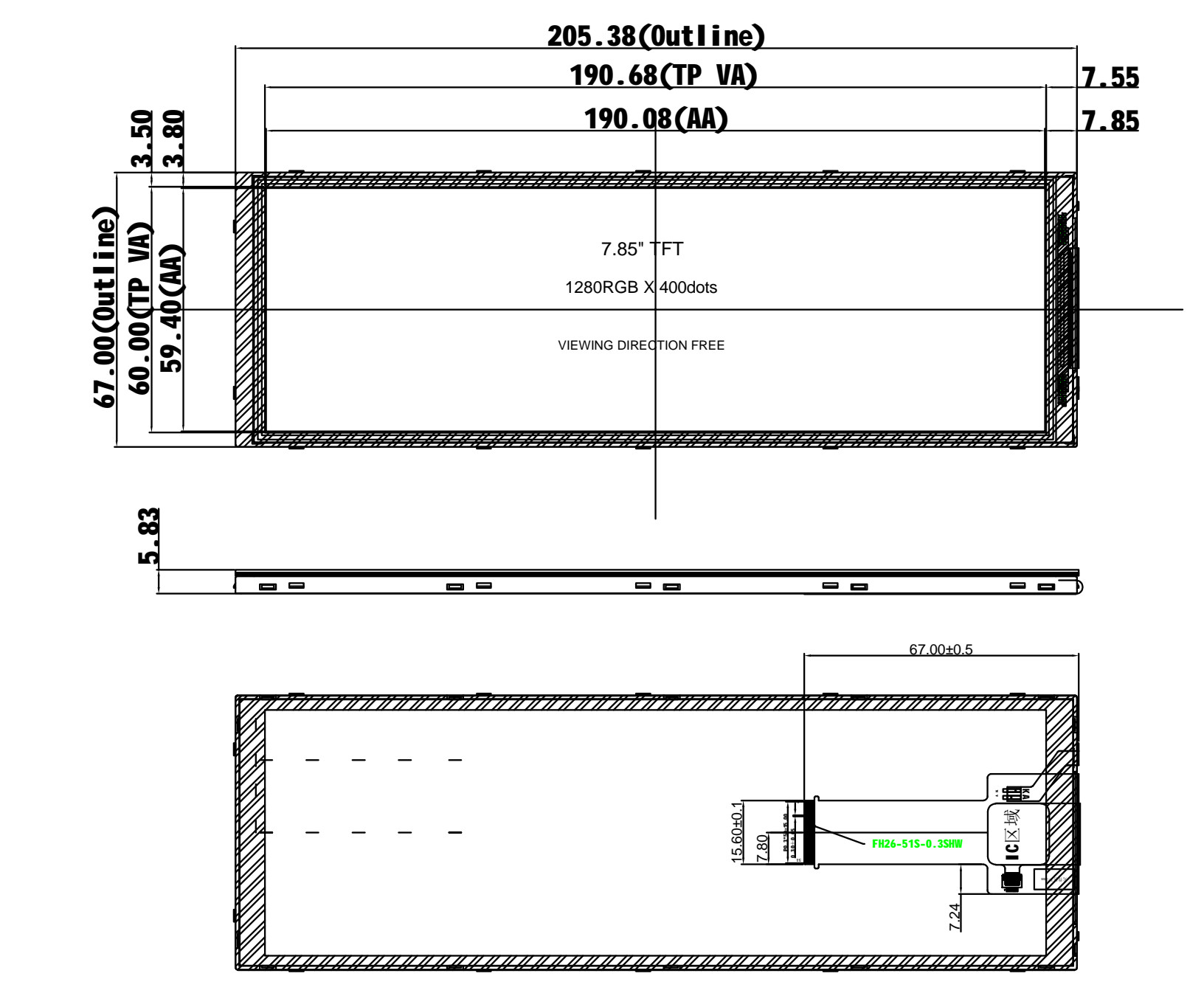

7.85inch Long Retangle Screen Dimension

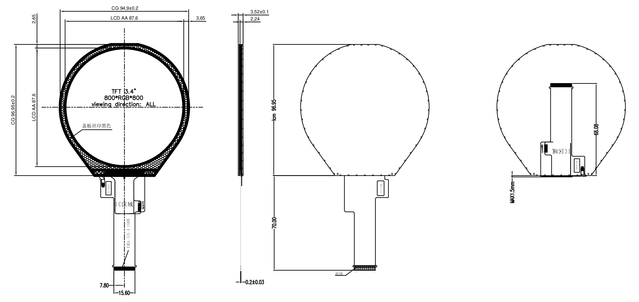

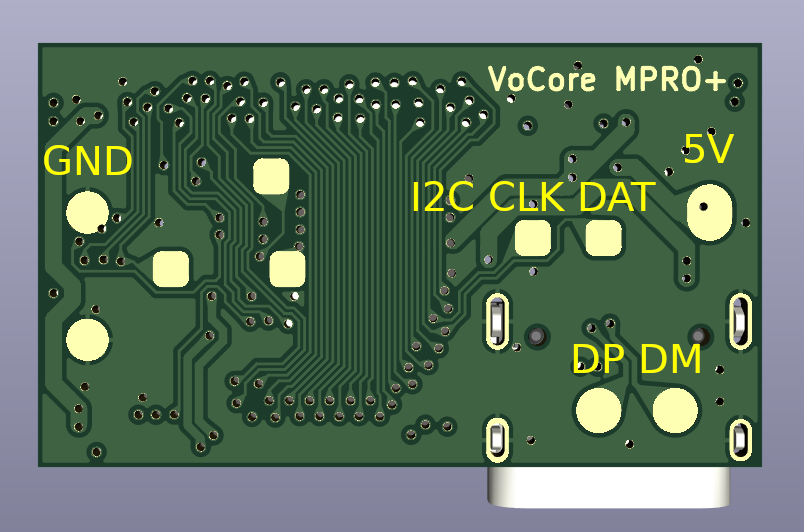

MPro Screen Driver
MPRO 3D MODULE: Download
MPRO KICAD FOOTPRINT: Download
MPRO TEST POINT: POWER = 5V/GND; USB = DM/DP; I2C = DAT/CLK(both have 5kR pull up); OTHER PINS KEEP UNCONNECTED
